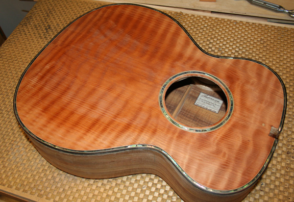

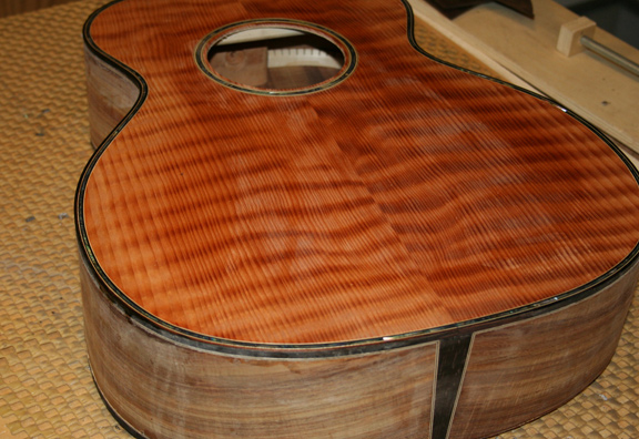

Abalone purfling is in, and all I need is one back binding to go on do some scraping sanding and its ready to finish!
Once again, the semi double top made a huge difference in the way to top rings.... deeper bass and sustain.
I'm very happy with it!
PostPosted: Tue May 29, 2007 11:09 am
Looks great
I wish I could do the miters like that

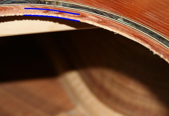

how 'bout a closeup of the soundhole edge Peter?

Peter, Theoretically, will the double top be more resistant to changes brought about from RH extremes? Also, is there more of the redwood or more of the other?
PostPosted: Tue May 29, 2007 2:37 pm
Very nice, Peter.    I understand "double top", explain semi-double top, please.

[QUOTE=Terry Stowell] how 'bout a closeup of the soundhole edge Peter?[/QUOTE]
Here you go.

[QUOTE=joe white] Peter, Theoretically, will the double top be more resistant to changes brought about from RH extremes? Also, is there more of the redwood or more of the other?[/QUOTE]
From my expirience with double tops, changes in humidity will affect these tops equally (unfortunately!)
Normally on Semi doubles, I leave more of the top layer unless real unstable or weak wood.
PostPosted: Tue May 29, 2007 3:42 pm
Posts: 1969
[QUOTE=peterm] [QUOTE=joe white] From my experience with double tops, changes in humidity will affect these tops equally (unfortunately!)[/QUOTE]It would be interesting to run the grain perpendicular on the inner layer. That could help, or make it worse.   It would be interesting to see what it would do to tone/sustain/bass etc.
PostPosted: Tue May 29, 2007 3:49 pm
[QUOTE=SteveS] It would be interesting to run the grain perpendicular on the inner layer. That could help, or make it worse.   It would be interesting to see what it would do to tone/sustain/bass etc.[/QUOTE]
Steve, after all the research I have done on double tops plus the few I wasted trying, running the grain perpendicular stiffens the too much and actually dampens a lot of the sound. No good....
Keep in mind, my semi-doubles inner layers are not solid but empty in areas that I believe help loosen the top and still keep is strength.
PostPosted: Tue May 29, 2007 6:09 pm
[quote]Here you go.[/quote]
WOH! That looks thin! Like .030 thin! Ight?
   Beautiful work! The redwood is awesome!
PostPosted: Wed May 30, 2007 1:52 am
Billy, the inner layer is about 0.55"
PostPosted: Wed May 30, 2007 2:57 am
I think there is a second layer below the redwood Billy
PostPosted: Wed May 30, 2007 2:58 am
Oh and very nice looking guitar there Peter.
I really like your work.
PostPosted: Wed May 30, 2007 5:45 am
[quote]I think there is a second layer below the redwood Billy[/quote]
   Thanx Rod and Peter! I didn't see that!
